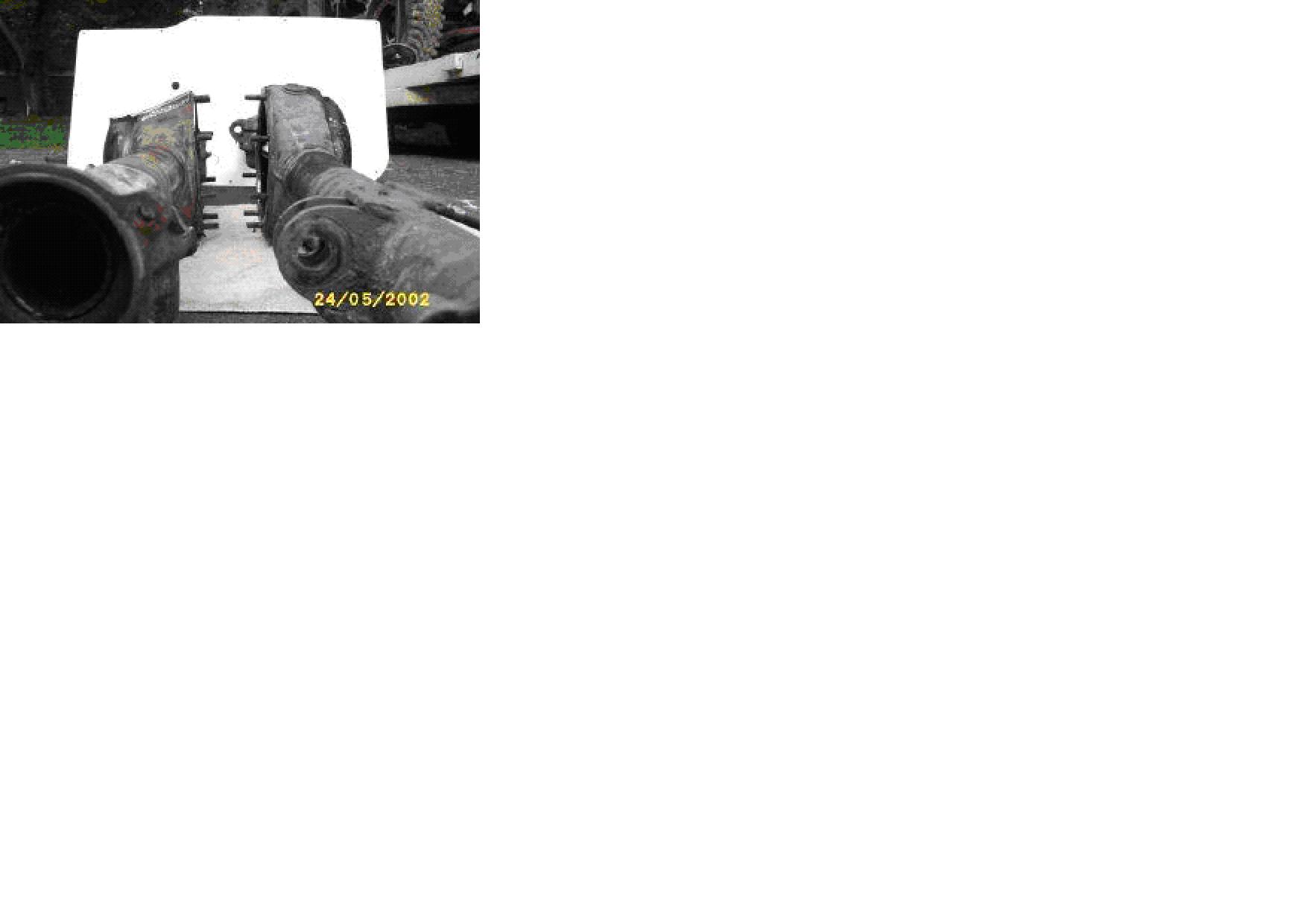

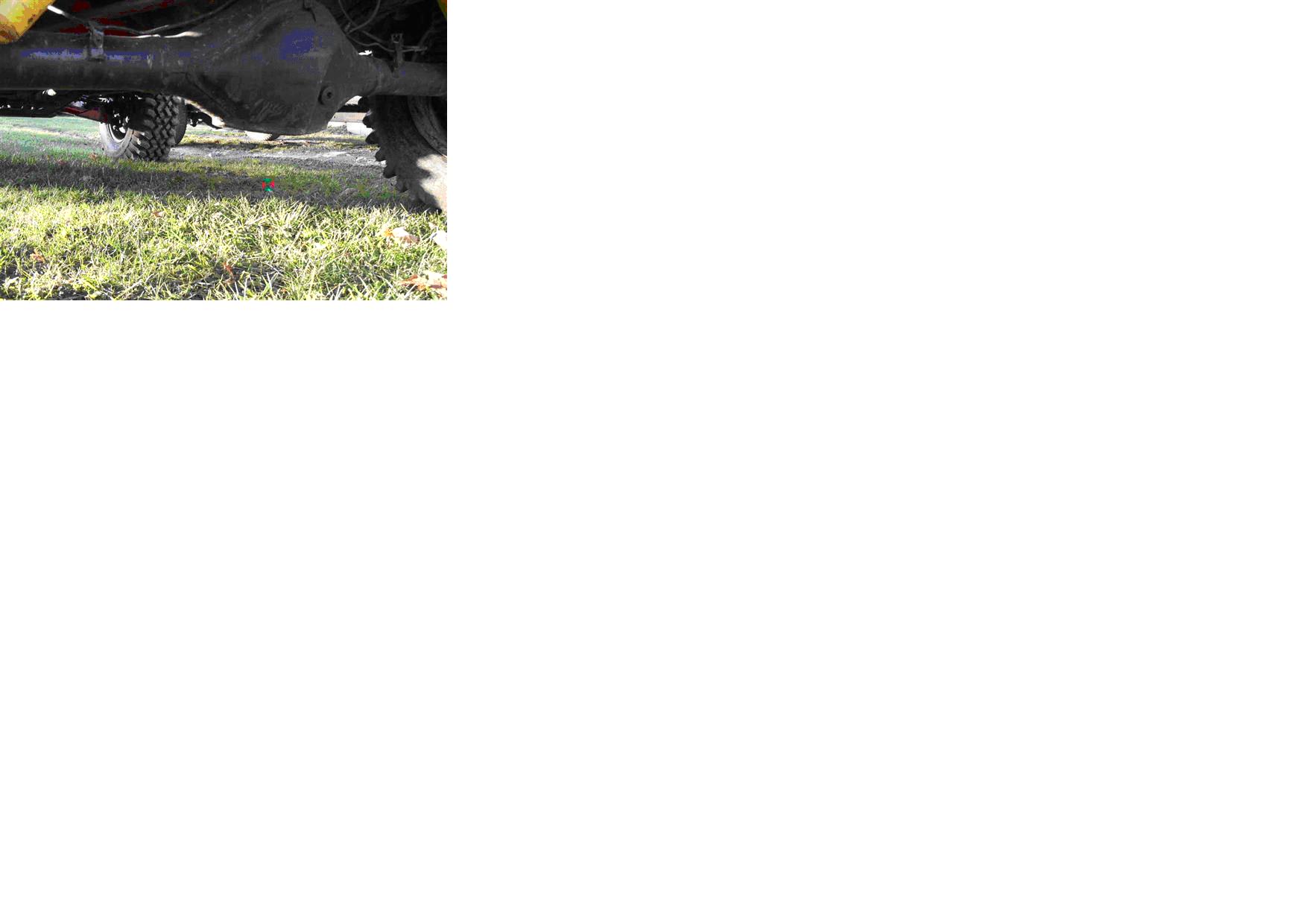

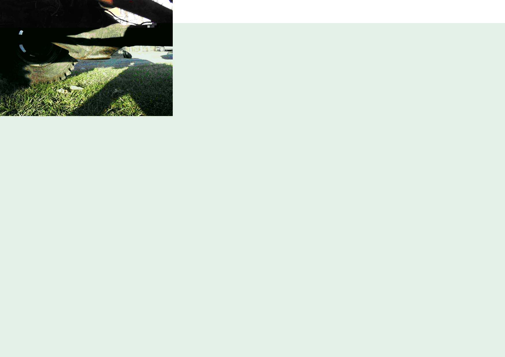

Following on from the axle rotation if you also shave the diff you will gain a substantial amount of diff clearance too.
Kerry Wittig in the USA shaved his diff in conjunction with the axle rotation gaining 48mm (1&7/8”) clearance using ¼” plate and replaced the 2 bottom carrier mounting "studs" with bolts for draining the oil.

Is there a direct correlation between diff lifespan and diff shaving for a daily driver?
Re: Vitara mods
I don't think it would be measureable.
Yes, there's a reduction in oil capacity, but a slightly more frequent change interval should see to that.
