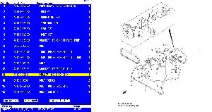

Hey CJ where did you get that number from ?cj! wrote:Ask them for a price on 49160-77E01 pulley, belt tension.
The JPG file is exactly what the Suzuki parts guys were looking at.
I have seen 2 mechanics who have tried to source one from a third party.. No luck
One mechanic re packed it with grease etc but it is still abit noisy.
Suzuki also wrote another number down 49120-65-d30.
I think it will of to Suzuki we go for a new one anyway??
Re: Bearing suppliers ????
Andrew, that number I gave you which is on the jpeg is from the Suzuki Electronic Parts Catalogue (EPC). The other number which you mentioned appears to be a variation of the bracket number, possibly updated. Ask them for a price on the number I gave you.

I don't think you've answered the question though, it is a pulley? It looks from the EPC like it has a concentric piece in the centre that acts as the tensioner. If this can't be removed, then you're dealing with suzuki, regardless of what the bearing is.andrew_wale wrote: I have seen 2 mechanics who have tried to source one from a third party.. No luck
I'd be pretty confident if you took the concentric bit out of the centre it's just a bearing.
The suzuki part numbers will mean nothing to a bearing supplier - they will need to see and measure it.
The clue though is in the description. If it was just a bearing, it would be described as a "power steering tensioner pulley bearing" but as it's described as the pulley, it's an assembly. Like I said, it all depends whether the centre can be pressed out.
