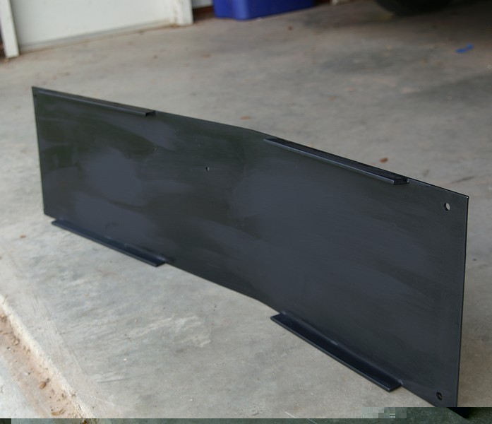

5mm steel plate
5mm steel plate
5mm plate with 6mm side reinforcing

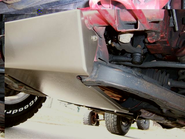

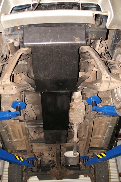

Vit lwb with 3.4mm front plate and 5mm rear plate

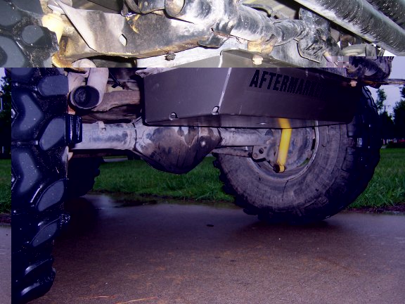

Here are the fuel tank plates.
3.4mm thick with sides and gussets

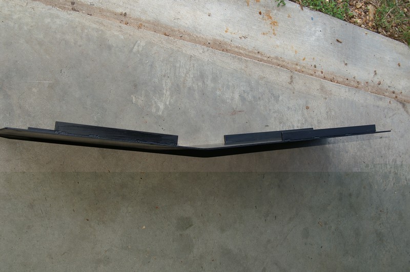

5mm plate
5mm plate

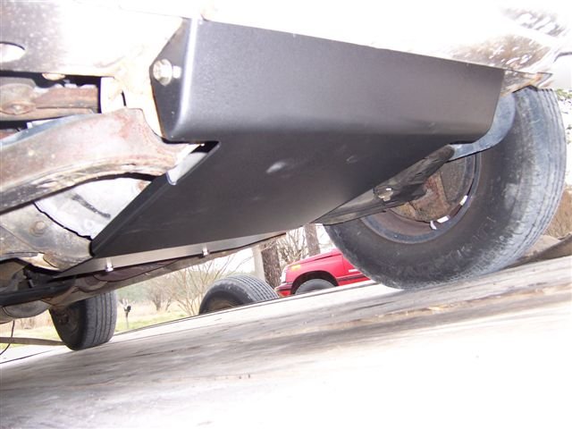

A couple of better pics of the front plate.
3.4mm plate
3.4mm plate
3.4mm plate
3.4mm plate

If the plate is designed with sufficient stiffeners/ribs, 3mm should be fine. a 5mm thick plate of the sizes posted will be pretty heavy, and with the design posted, also offer a poor strength/weight ratio.
In relation to fuel skids, I like the idea of a thin and close fitting plate with neoprene (wetsuit material) between the plate and tank. This prevents rocks/mud chewing out the tank and the sandwich effect means light plate is plenty strong enough as it has been backed up by the tank itself.
A word of caution - Wayne and Christine had an crisis near Alsice springs when they holed their sump due to a small rock sitting ebtween the bashplate and the sump.
Like most modifications, they can be a bit of a minefield.
Re: Skidplates Bashplates
gwagensteve wrote:If the plate is designed with sufficient stiffeners/ribs, 3mm should be fine. a 5mm thick plate of the sizes posted will be pretty heavy, and with the design posted, also offer a poor strength/weight ratio.
That was my thought. There would be a lot of weight if it was 5mm. That middle plate alone is around 1200mm x 300mm.
Mmmm, hadn't thought about that idea. Doesn't sound too bad, might be the way to go. I know most aftermarket long range tanks are done with 2mm bottoms with 3mm being the heavy duty option. What thickness do you reckon for a plate with neoprene in between?
I would have thought 2mm of steel would be plenty, with 5 or 8mm of neoprene then the normal tank bottom. The effect of spreading the load means it will be almost impossible to dent set up like this. Of course, there are limits, but strength/weight has to be taken into account. Sure 10mm of bisalloy would be the shizzle, but who wants the weight?
I got the neoprene idea from Camel Trophy - Land Rover plated the fuel tanks on camel trophy cars with about 5mm of aluminium and padded neoprene between the tanks and the plate. I did this with the tank on my Gwagen after discovering it was almost holed with abrasion between the factory skid plate (about 2mm thick) and the tank (somewhat thinner)
That was about 8 years ago. It's had more hits than elvis since, and although the bottom of the tank isn't dent free, it's pretty good considering the weight of the car and the use.
The real key is shaping the skid with rolled edges or a lip to stiffen it.
