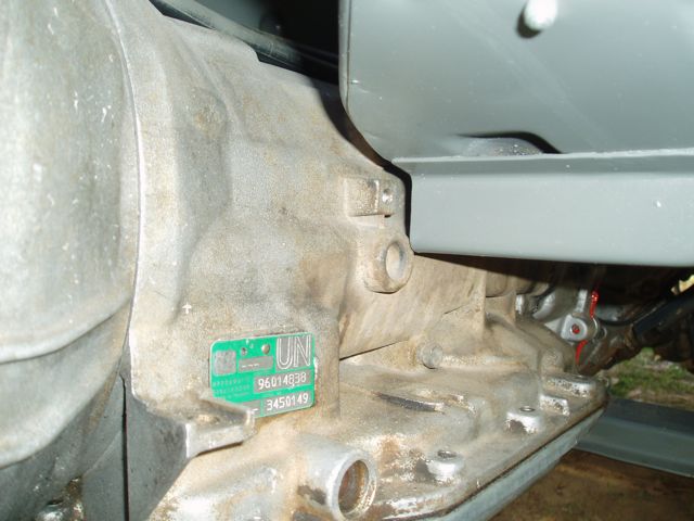

The Engine and gearbox are bolted together, the cover plate between the motor and bellhousing was fabricated

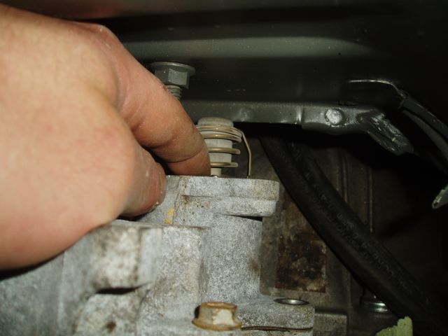

The TV cable (Kickdown cable) has been fitted. This was a F$%#% nightmare as it only has about 5mm of travel and has to take up at exactly the right point. It doesn't only control kickdown, it also controls line pressure under hard shifts so it has to be right.
Urethane transfer mounts have been fitted, raising the case about 35mm. A straight Passenger side transfer mount was found.

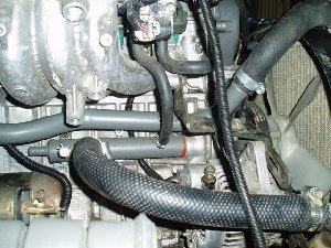

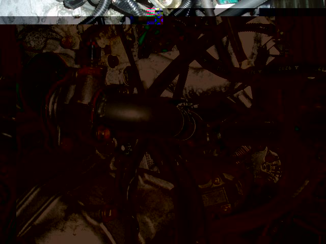

I fabricated a water pipe, but it ended up needing to be reworked - see the photos.

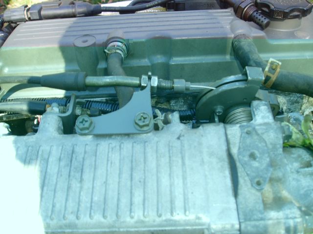

The Baleno throttle cable will work

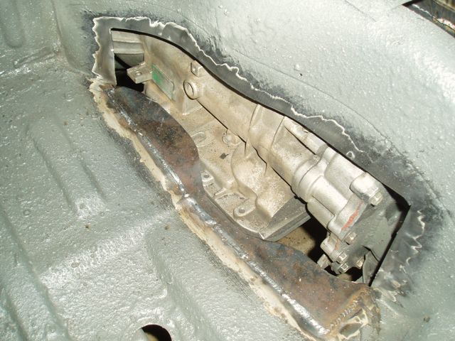

No clearance at tailshaft housing

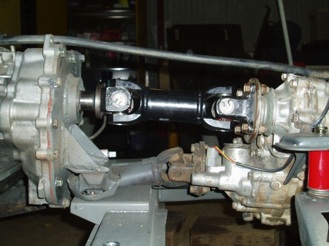

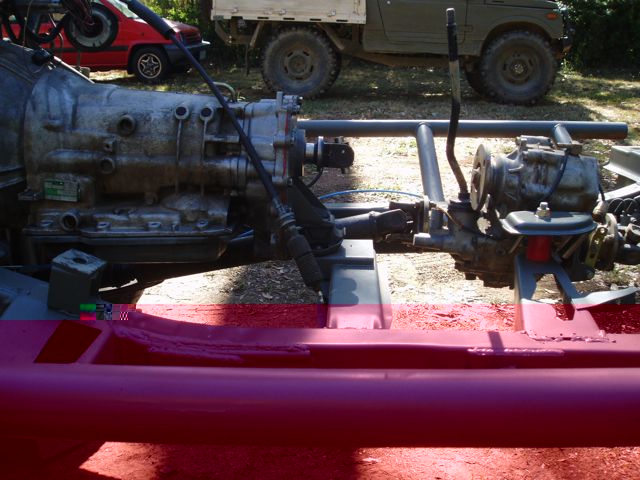

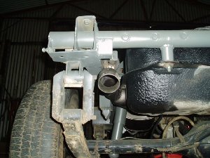

Jackshaft angle
Jackshaft angle

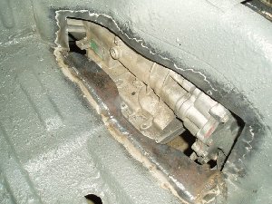

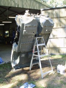

Tub getting paint
Tub getting paint

TV cable installed.
TV cable installed.

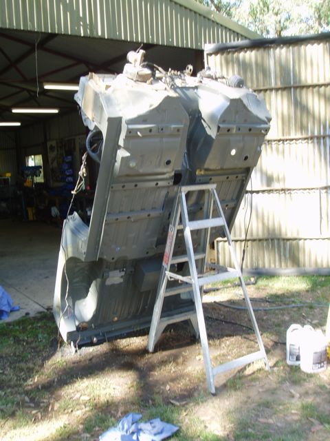

Michael and I put in a big day today - lots of jobs ticked off the list- I'll post more photos tomorrow. The body is back off the chassis ATM for a clean up underneath after the tunnel widening and to build the exhaust. Body should be bolted back down for good tomorrow.

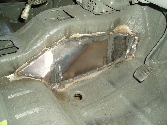

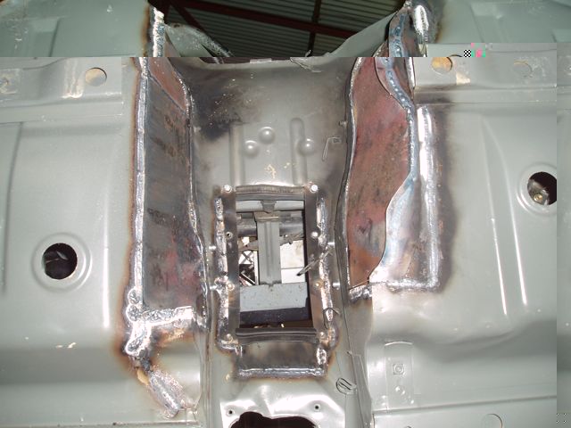

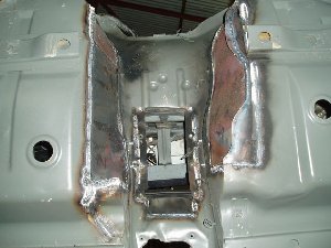

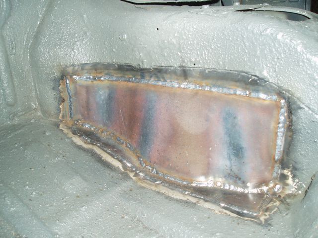

The cuts in the floor have been plated up and painted, and the tunnel has been smoothed and painted from the underside as well.

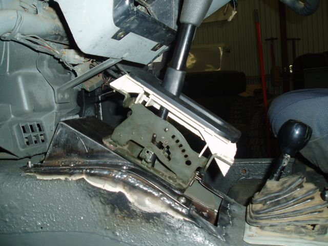

The low range shifter was bent and welded to clear the auto shifter

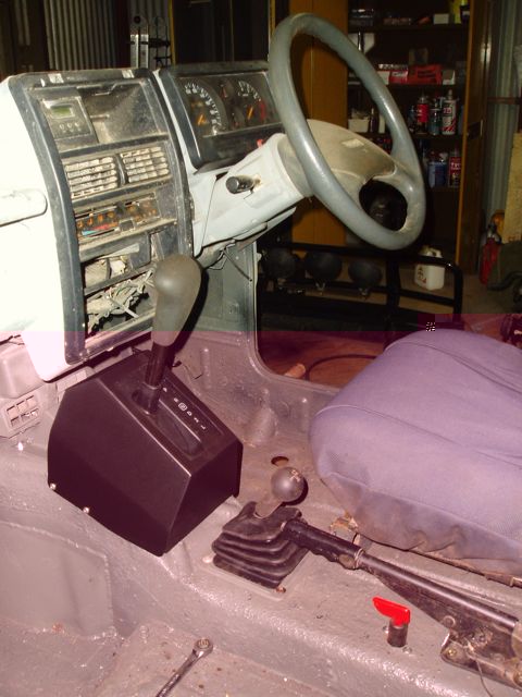

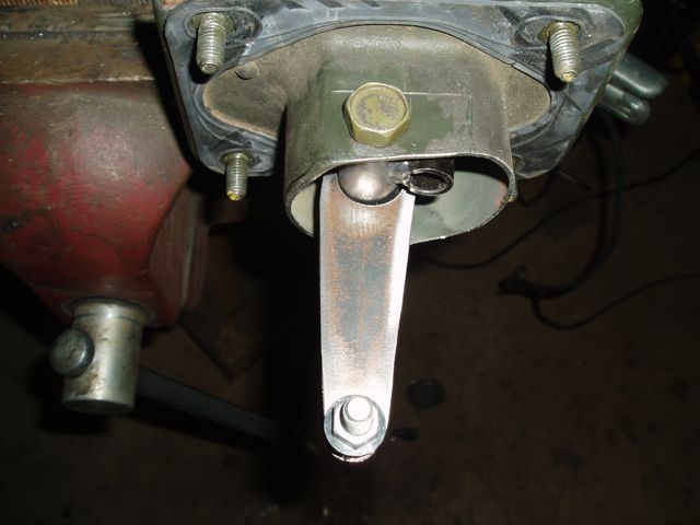

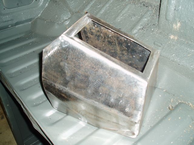

The auto shifter was mounted and a shroud built. This was a MASSIVE PITA as the shifter we had (and most suzuki shifters, as it turns out), "pushes" the cable towards park. The trimatic needs to be "pulled" towards park. Normally, this can be achieved with a rear mounted cable, used by most GM autos, but in a sierra, there is no room to have a rear mount cable, so we had to modify the shifter to make a new pivot.

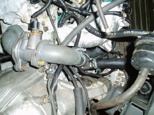

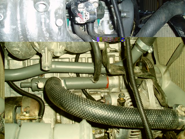

The water pipe was reworked to turn the thermostat housing through 90˚ and lower it, and then turn another 90 and point it at the front of the car. This is all complete now. It will be fairly hard to change a thermostat, but not impossible, but the way this ended up was miles neater than running down the side of the valve cover as has been done before (and the factory do on the 2.0 motors)

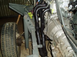

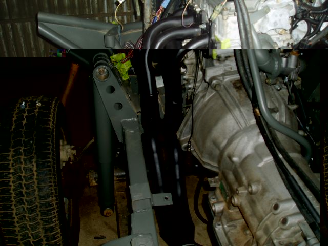

Muggins (ex Cj) extractors were cleaned, painted, swapped to a 2 bolt flange, and mounted. a very nice fit once a small section of motor mount bracket was removed.

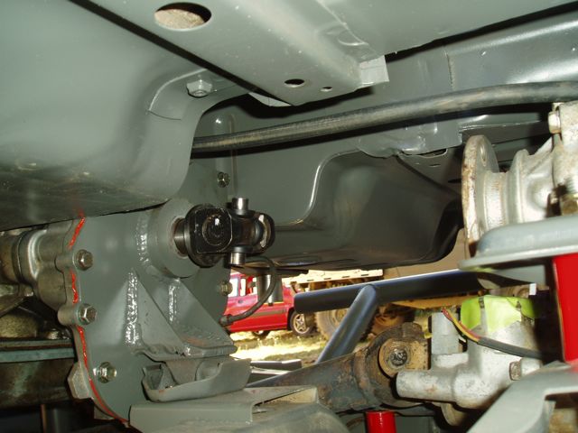

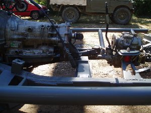

The jackshaft was professionally shortened and balanced by Ken Hastings balancing in Chifley drive, preston. It was fitted with new unis.
The tension transfer mount (passengers side) was lifted another 20mm, this removed nearly all the jackshaft angle. 8-)

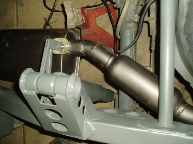

The exhaust was built. It runs 2" up to the resonator and 2.25 after that, (only for aesthetics and to lower the note) it runs a generic 2" cat, a straight through muffler and a resonator. we'll see how loud it is, but it should be OK. It's all mandrel bent, runs flanges and is painted. nothing is below the chassis. It sits in three stock suzuki rubbers.

finished jackshaft angle
tunnel finished - passenger side
Tunnel finished
Tunnel finished

shifter mounted
shifter mounted
Shifter converted to reverse throw
Tunnel from underside - complete

extractors fitted
extractors fitted
water pipe from side complete
water pipe complete
water pipe complete

tailpipe location
tailpipe location
muffler and resonator around shock
exhaust complete
exhaust complete

shifter complete, note isolator
Shroud for shifter
Shroud for shifter
