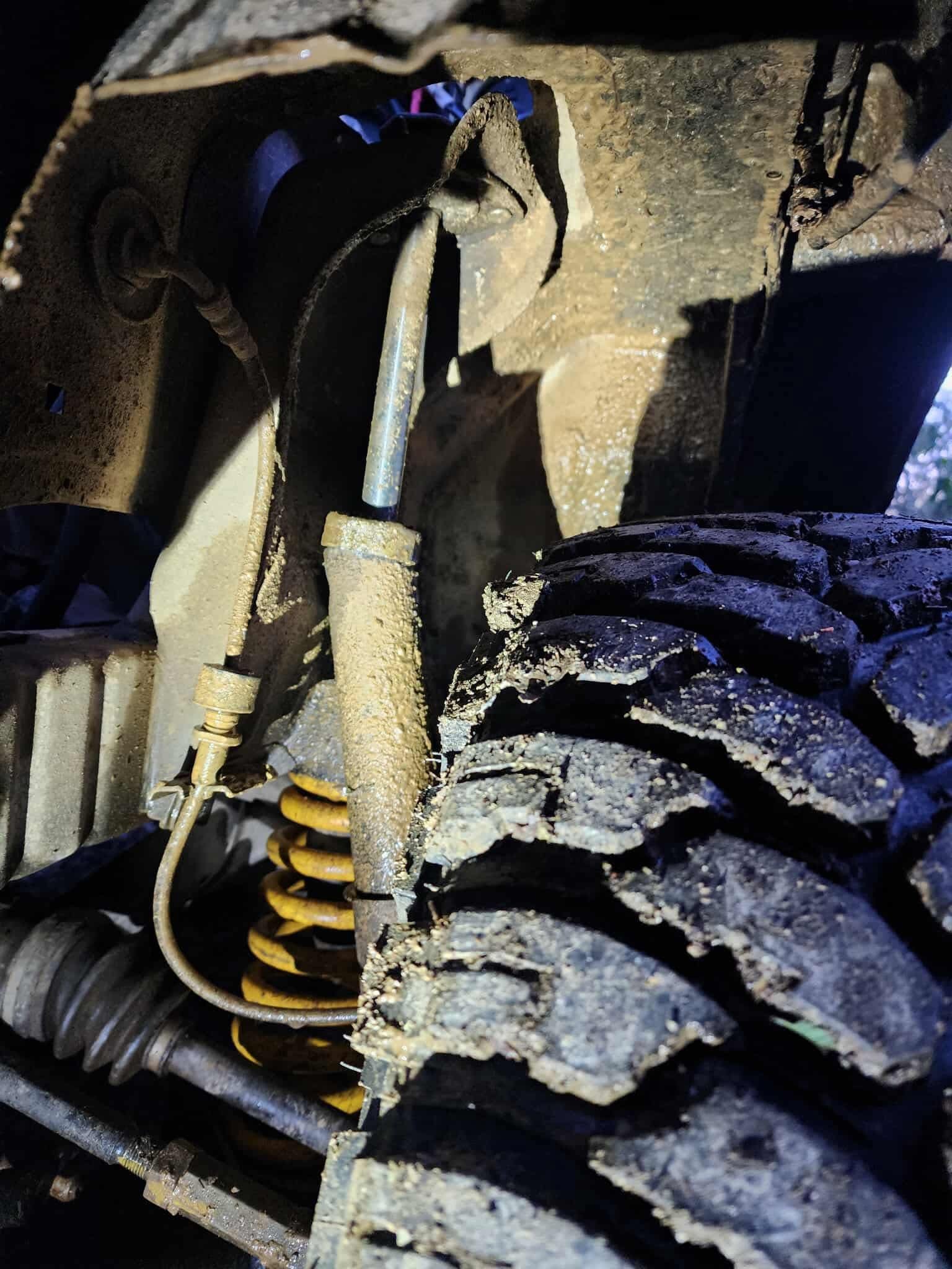

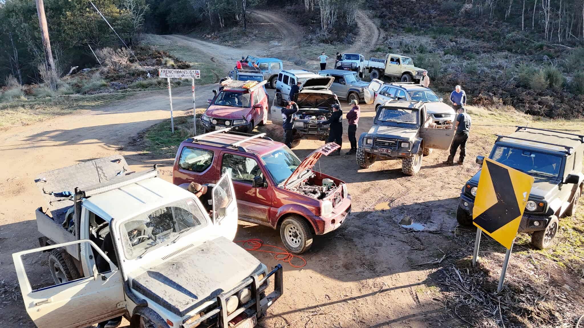

On Friday after a bit of a slow start, we left the hut and set off for one of the more difficult tracks nearby that takes you down into the valley to a creek crossing and up the other side, after a long and difficult descent, we crossed the creek and on the other side found that we had a few issues. My air compressor had stopped working which meant no air-lockers, and Owen had broken a CV in the Vitara coming out of the creek. After a few short winches we were on flat ground and able to diagnose the issues. My issue turned out to be a bad relay, so I swapped it out with the one on my lightbar, and Owen replaced his CV with a spare, and we were back moving again in no time.
After a little more driving and some other short winch pulls for a few cars on a few sections, Owen heard something go bang and presumed it was his other CV, so we had lunch while Owen replaced the other CV trackside. Unfortunately this didn't seem to fix the problem (despite us then replacing the FWH and some other items) so we suspected the auto locker had broken inside the diff and wasnt going to be fixed in the bush. With Owen down to 3 wheel drive, this track was looking a lot more difficult, after a few long winch pulls, we then hooked Owen up to my car and towed and winched him out of the track. With the day getting on, we decided to head back to the hut before it got dark, and settle in for another night. Owen also broke a strut at some point on the way back which he replaced that evening.
