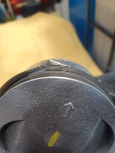

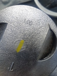

Here is pick of piston and ring with N 100:

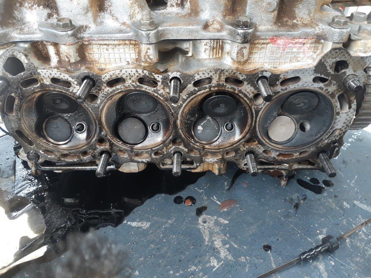

while talking tech. What do you make of different color valve on number 1?
Re: Measuring cylinder size
I would have thought 1.00 was 1.0mm over stock. That should be easy to measure with a vernier on the top of the block. As Mitch points out, g13’s are open deck and ovalise their bores. If the bores are already +1 then I don’t think you can rebore.
Unfortunately G13’s don’t respond to a hone- they’ll start smoking again pretty quickly. They really need to be rebooted with a torque plate on the block. As Mitch points out, the machining work cannot be justified based on the price of the motor.
I think the piston markings for oversize pistons are in the FSM but I don’t have it handy now.

just check the bottom flange of the block to make sure this number wasn't an assembly number.
there will be 4 numbers in a row (like 2 2 3 2), these were used on the assembly line to get the right pistons into the correct hole, as there are not all the same size.
but looking at that piston pic, it looks like 1mm over which is close to .040 thou over bore.
number one cylinder looks to be running about right, the rest are burning oil.
number one valve is white cause its hot, with minimal cooling unlike the intake valves that have fresh charge flowing over them.
