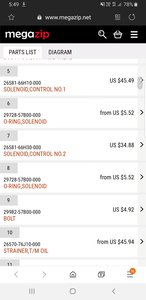

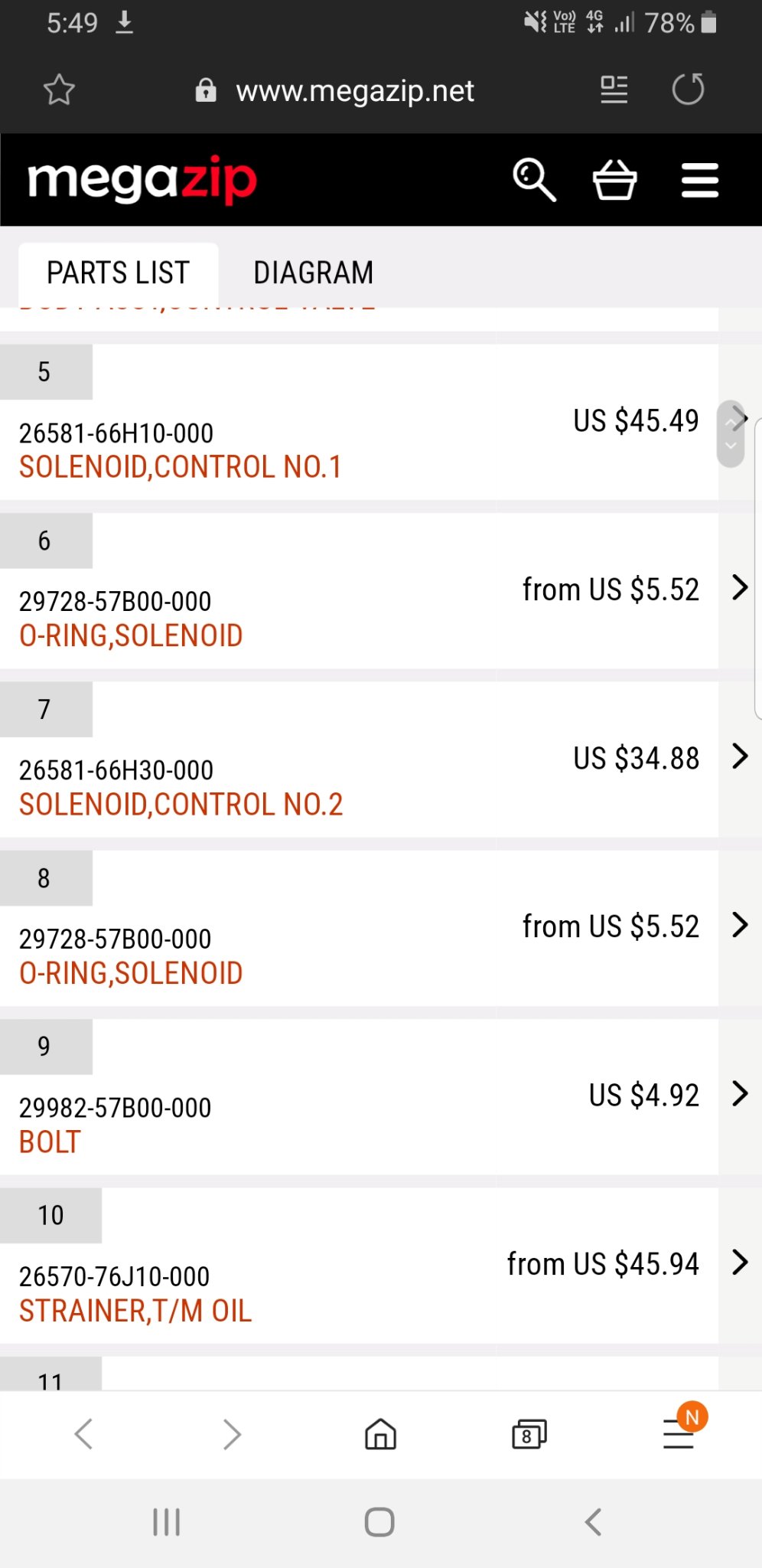

The shift solenoids are parts 5 and 7 in the diagram. They can be check with a multimeter from the main plugs to the transmission which should be near the firewall.
This is from megazip.net
