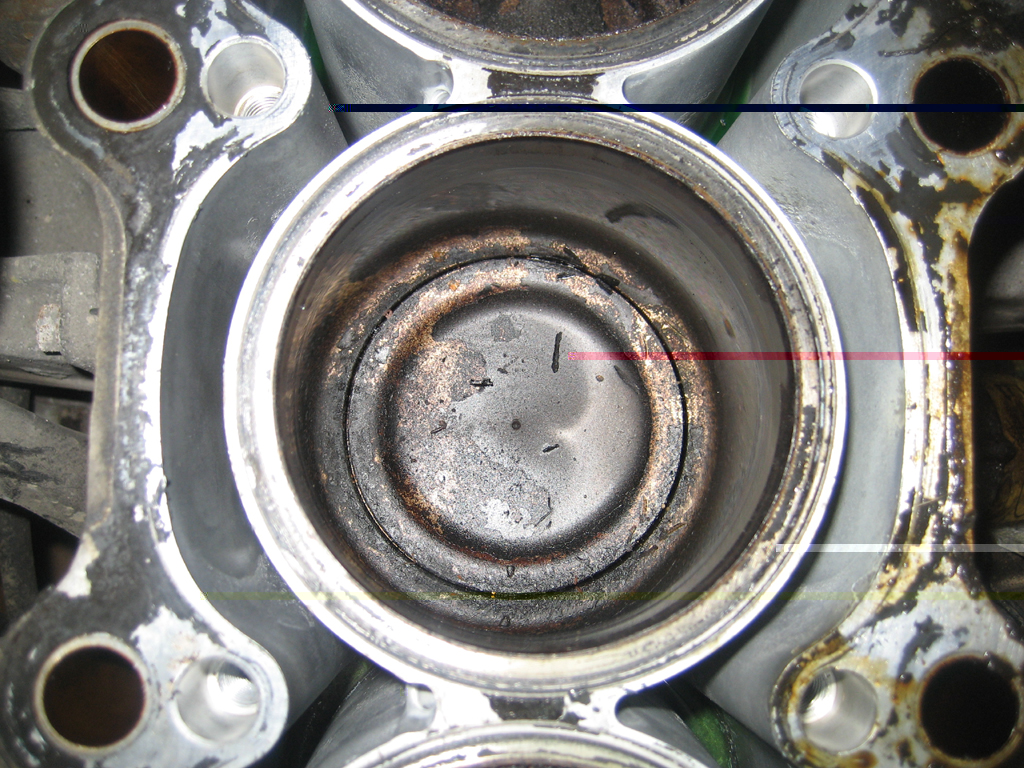

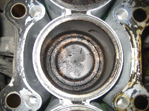

I wonder how much meat is required around a cylinder liner to keep things happy? The reason I'm asking is the J20A 2.0 4cyl has a bore of 84mm. In the US they offered big bore version called the J23A with a 90mm bore. Both engines run the same 90mm stroke and the piston pin size is the same. I know of someone running an 87mm bore with Honda hi-comp pistons and he seems to think 90mm would be fine. If at some point the engine needed work it might be a mod to consider as it is internal therefore not visible to anybody and getting pistons, rings and a head gasket shipped wouldn't be too bad. The 2.3 offers an increase of around 20% more power and around 25% more torque over the 2.0 but I don't know how much of that may be contributed to by other factors such as the cams, valves etc. I've got a couple of pics of a J20A and I'm waiting for the guy to get me some measurements but looking at the pic I reckon the outer dia. is around the 101mm mark and if I used sleeves with a 2.5mm wall thickness I'd have a wall about 3mm surrounding that.

I emailed LA Sleeve the pics of the block and told them what I want to do and I got this reply'
"We haven't made a performance sleeve for the Suzuki yet but it looks possible. Looking at the picture you emailed, it seems to me like it would be simular to the Honda's we make sleeves for. We would make the flange bigger than the waterjacket. Usually 1.500" down on the flange. Then, the outer diameter would taper down below that. It would press on that area of the sleeve. Depending on what aluminum is left between each bore is what determines your press fit. The average press fit is .001 to .002. Let me know if you've any other questions."

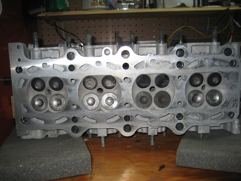

In markets such as North America, Europe, Japan and the Middle East the new Gen 2 Grand Vitara's and the SX4's fitted with the J20A have a 10.5:1 comp ratio compared to our 9.5:1. The pistons are different for these markets and the part numbers are 12100-65820-0A0 for red piston
12100-65820-0B0 for blue piston
It might not be much but for those who happen to be rebuilding an engine and looking for a bit more power it may be worthwhile importing some high comp pistons and running it on 98.
