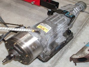

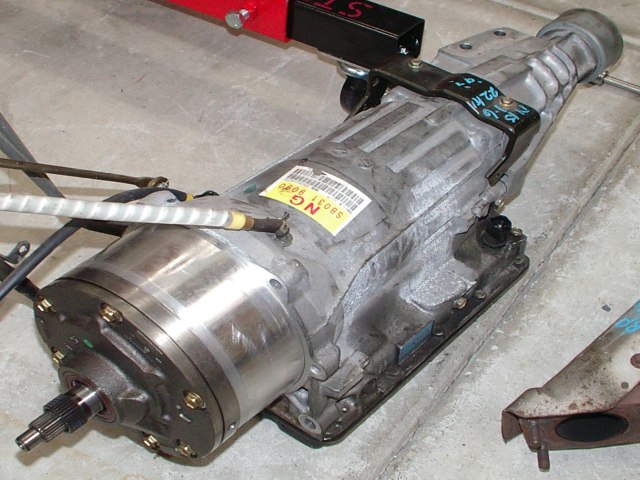

Turns out that some Mazda MX5/Miata's run an Aisin Warner A44DE gearbox.
However the MX5 autos seem to be as rare as.... so its technically easy but some may find it a challenge to source.
The U.S. was the major market for MX5/Miata autos apparently
This means that the "correct" MX5 auto bell housing will go onto an A44DE ( that a Vit AW4 auto ) thus opening up an interesting range of engine options. This is NOT speculation

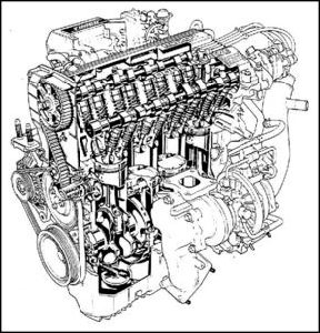

Any of the Mazda B series 4 Cylinders will then bolt on, ranging from the boring SOHC 8 Valve 1.1 ltr - which is getting very old now, to the interesting 1.8 ltr BPD, producing 154 kW and 250 Nm. The later 2.0ltr and 2.4ltr variants are not compatible - but aren't as powerful anyway ( no turbo... ).
Contrast this with the lousy 109kw out of the troublesome Suzuki 2.5 ltr V6 and you will see the point.
As an aide the old 2.5 ltr Suzuki V6 started out as a joint Mazda / Suzuki venture. Being designed for N/S and E/W installations each manufacturer designed their own cam drives - enough said. Mazda kept developing the motor to its final form - 169kW where as Suzuki just kept it and its problems essentially unchanged. Even though they share a common heritage NONE of the parts now interchange and its unsuitable for a N/S installation for a number of technical reasons.
The most obtainable is the BPT. producing 134 kW and 237 Nm of torque.
These have a great reputation as being extremely strong and long lived.
Would be interested to see how 154kW and 250Nm would push a Vitara or suchlike.
Another bolt on engine option.....

wierd question - are you sure mazda vans don't use a B series motor/AW-4 variant? Might make the bellhousing easier to find...
Despite the water/air, Cj will have a larger than stock intake volume because all the rest of the piping is the same (cooler sits in the same spot as the stock 660 one) but has a much larger internal volume, larger core and tanks, but I agree that the BPD motors intercooling could be improved from an off road point of view.
Re: Another bolt on engine option.....
Sure - no.... just didn't find any other SUITABLE listings of an EXACT match in any of my searches.
KIA use - but its way too heavy an engine etc etc.
Would open the market up if it were true so others might find it worthwhile.
There are so many variants of the Aisin Warner transmissions ( 3 speed, 4 speed lockup, no lockup, different input shafts, output shafts, extension housings, different ratio's etc etc ) that its VERY difficult to predict exactly what could go with what, even the experts get vague.
They must have a master index or something as he could tell me there were X variants with Y belhousings and Z output shafts, but when I started discussing interchangibility progress stopped.
So its a case of I know an MX5/Maita bell housing works - I've bolted them together.
I know the MX5 bell housing fits the BPD, Ive also bolted them together.
The converter is a bit more of an issue, the BPD was only available in manual but I have an MX5 converter thats not a precise match but that's better than can't do. Converters are also pretty well understood and aren't anywhere near as difficult to resolve.
About all i could get from the Auto Trans experts was vague answers and rediculous $$$, why would he bother with a "toy" Suzuki trans when he could make $5000 building auto's for patrols ? What can you say to that ? And if parts did need to be swapped he'd only do it as part of a total rebuild, even though the box is less than a year old.
