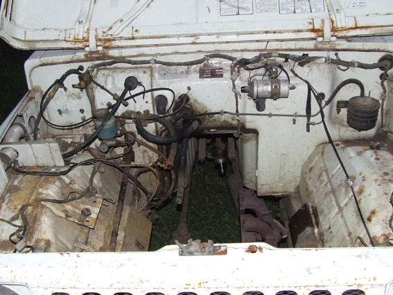

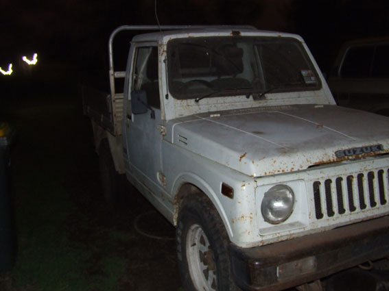

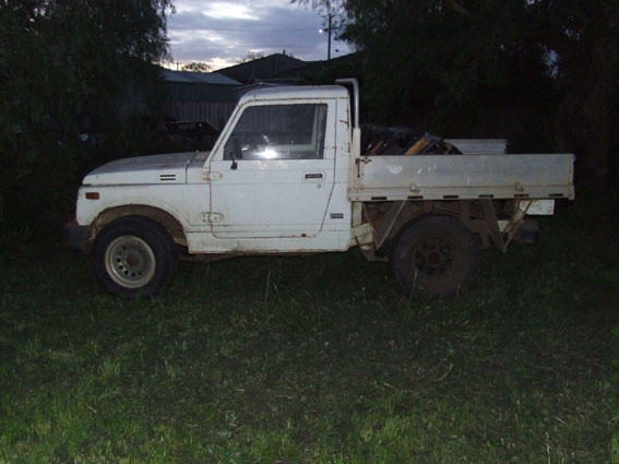

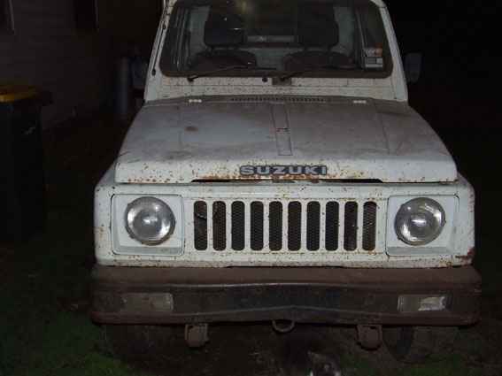

Been offered this LWB by Aaron from the Geelong club, he bought it for the engine and is now selling the rest.
He says the only real rust is in the left door, left guard and that a plate has been welded near the left hand windscreen wiper.
I am tempted to buy it but think the windscreen rust could be too much drama.
Am I asking for trouble?

The windsceen wiper repair is common on these - they normally start off by cracking. This area was beefed up on the 1.3's. A couple of hours to repair.
One thing to check though- look for cracks in the roof. They're prone to cracking at the front and rear edges of the pressed ridges on the roof. It's not a huge deal to repair, but it's annoying.
Doof, Chris's car and Piggles are all cracked in this area.

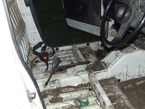

Also, check for rust around the sills behind the front wheels. Piggles was VERY rusty in this area. It's not a common area for rust but is pretty fiddly to repair - on piggles I cut the whole floor and the inner sills out and replaced them with good ones. If it's lived on a farm there might have been enough mud over the years to fill up this area and cause a problem.
If the price is right go for it- I'd buy it - it looks a lot better than Piggles.
Bear in mind that it's obviously not a runner so the path to getting it out on trips is a big one - you have to work out whether you do the big build from scratch or buy a 1.0 motor or donor car to get it running stock then talk to an engineer. Obviously you can't RWC or register it until you make that descision.
It's definitely the best starting point for a project though - there's very few ADR's to contend with due to it's age and status as a commercial.
