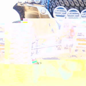

Simple but interesting idea for capable and long range 4wd EVs
Basically deisel electric with genny on board.
Light weight and capable.
Could work in Aus

May never go into production, but there is one in prototype testing.
Portals double the value :)
