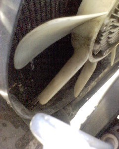

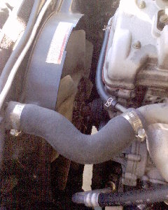

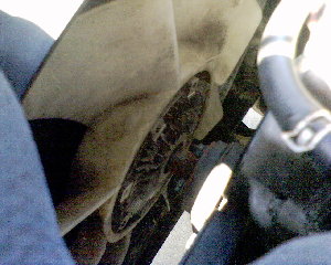

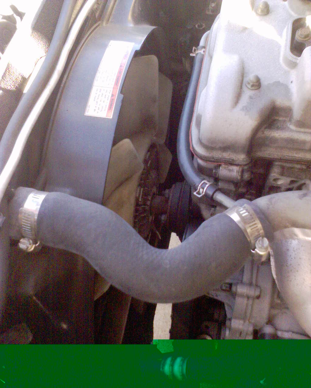

I need to look at my fan setup on the Vit. To be able to mount the winch back as far as possible I really need to remove the A/C fan on the condenser. Now as I'm a bit soft I also need to keep my A/C functional so the idea is to replace the existing engine cooling fan with a thermo that can also be used as a pull through fan for the A/C condenser as well as being the engine cooling fan. As I understand it this is done on some vehicles by manufacturers so it should be achievable. I would need a thermo switch for the engine and a switch for when the A/C is used and also a switch to shut it down for water crossings. Obviously it is ideal to have a shroud for optimum efficiency and as there is already one there for the Factory engine fan it would make sense to use that if possible. The hole in the shroud for the fan is 475mm or 18.7" in dia. and the Factory cooling fan has a dia. of 420mm or 16.5". The depth of the shroud is 75mm. Now it seems that 16" thermo fans are a fairly common size and I have seen some that supposedly flow around the 2750cfm mark. Here are a couple on ebay http://cgi.ebay.com.au/HIGH-PERFORMANCE ... otohosting
http://cgi.ebay.com.au/ws/eBayISAPI.dll ... :IT&ih=010
The Factory cooling fan has a clutch arrangement that has the fan doing about 500-800rpm when the temp is below 50deg. As the temp starts to rise and reaches between 50-70 deg. the fan starts to increase speed gradually. Once the temp reaches 70 deg the fan clutch turns on and the fan increases speed in proportion to engine rpm. Once the engine reaches 4000rpm the fan speed remains constant at 2250-2550rpm.
So the big question is will something like one of the thermo fans on ebay do the job?
