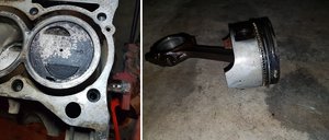

here is why my engine was smoking the way it did in Tassie
number 1 piston
number 1 piston

Posts: 130
Re: Mods and Repairs afternoon - Sunday 18th November
number 4 piston
number 4 piston
:cry: :? :shock: :o wow, good work
Post by greyghost »
carb or EFI?
looks like it was running lean, to melt the pistons

Posts: 130
Carby
