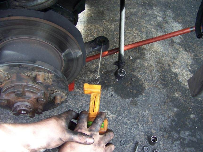

Suzuki suggest Preload should be shimmed to 4.5kg for Jimnys in their bulletin fix doc after:
Checking condition of all rubber bushings, check everything is tight especially the panhard and replacing the kingpin bearings..
The 4.5kg Preload in this case is the amount of force that is needed to start movement of the swivel hub, measured with the seals on from the drag link hole with a fish scale.
testing with scale.jpg (107.94 KiB) Viewed 5223 times
My understanding is that from the factory, Sierra swivel hubs are made too tight and should be shimmed with the big square shims until you lower the preload to 2-3kg. My sierras and the Samurai were at the lower end of this with no shims. Sierras are getting old and worn and out of round and sloppy.
On Luke's car we actually welded in a bead and refinished where the swivel seal sits on the ball as it was so badly worn that the seal was not adding any resistance in its rest position.
Jimnys were designed to have the right amount of preload from the factory with no shims and you add shims as needed as they wear.
There is a Suzuki part number for the shims, and they are only $5 but they don't actually ever have any in stock.
I cut my own from shim sheet for my current Jimny. Its not uncommon to need more than 1mm of shims.
