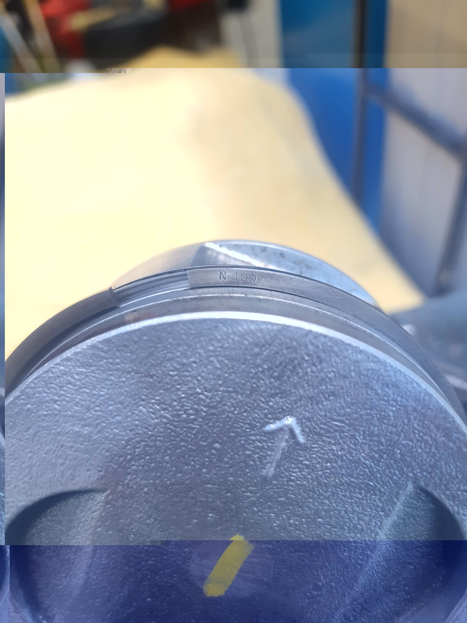

I also found a “N 100” on the rings. Does anyone know if this indicate standard size or oversize?

typically rings aren't marked with their respective sizes. there is always a first.
clean the tops of the pistons, if the block is over sized it will be marked in the tops of the pistons, as will STD size bores
if possible post up a pic of just one piston, and I'll try and decipher the size for you.

Here is pick of piston and ring with N 100:

I would have thought 1.00 was 1.0mm over stock. That should be easy to measure with a vernier on the top of the block. As Mitch points out, g13’s are open deck and ovalise their bores. If the bores are already +1 then I don’t think you can rebore.
Unfortunately G13’s don’t respond to a hone- they’ll start smoking again pretty quickly. They really need to be rebooted with a torque plate on the block. As Mitch points out, the machining work cannot be justified based on the price of the motor.
I think the piston markings for oversize pistons are in the FSM but I don’t have it handy now.

just check the bottom flange of the block to make sure this number wasn't an assembly number.
there will be 4 numbers in a row (like 2 2 3 2), these were used on the assembly line to get the right pistons into the correct hole, as there are not all the same size.
but looking at that piston pic, it looks like 1mm over which is close to .040 thou over bore.
number one cylinder looks to be running about right, the rest are burning oil.

Just reporting back on the results from this one. They ended up being stock size. ordered new rings, honed the bore and installed them.
Have probably done something like 500Km since installation and no smoke! So far so good!
