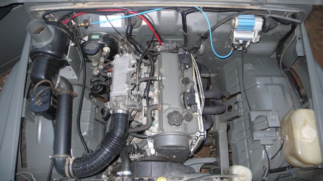

The air filter is done. We have used a 1.0 airbox which has a nice canister filter in it rather than the panel used in baleno/jimny airboxes. The airbox has been fitted about where the battery sits in a stock sierra. The inlet to the airbox is now 3" stainless pipe breathing straight through the bonnet. There's an 8" Donaldson Top-Spin precleaner on top of that. the top spin sits about 2.5" above the bonnet so "wash" from deep water won't swamp the airbox.

All panels were painted. Carbon canister was mounted, fuel accumulator was mounted, Heavy duty Air locker line fitted, the ammo boxes were fitted to the rear rack, the cover over the battery completed, lights rewired, brakes bled ( more of that in a minute) 1/2 doors fitted and painted, auto trans refilled (more of that too in a minute) idle speed adjusted and a few other little things done.

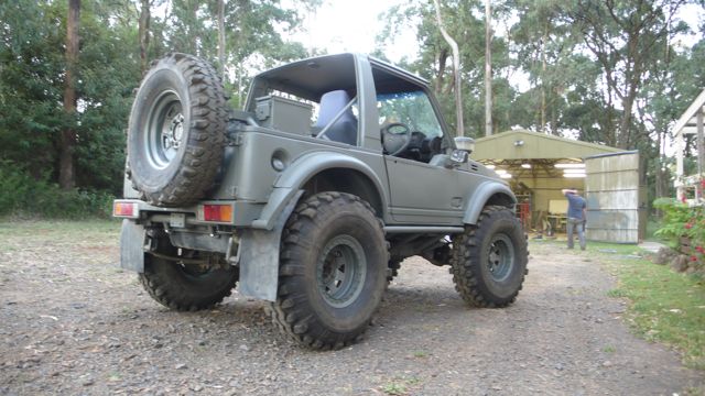

Here's the finished photos -
It's together, road tested, checked, and absolutely fantastic to drive.

And some more.
