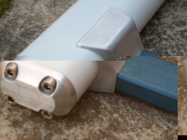

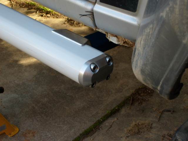

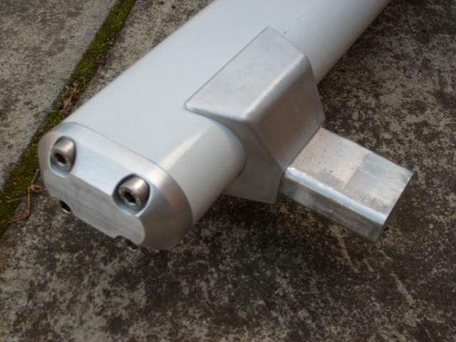

Pics of the "so far so good bit......
Slider Rail - 2011T6 extrusion I'm told. A bit thicker than I'd planned but...
Rail, End Caps and mounting stub
Rail, End Caps and mounting stub (alloy), blue bit is heavy wall RHS ( steel )
