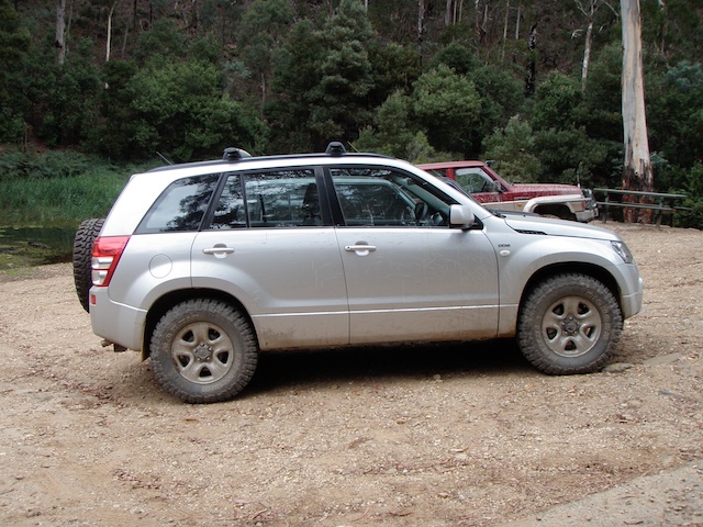

I had a 2008 GV diesel, came with alloys but I got a spare set of genuine Suzuki 16" steel rims from the dealer and fitted 245/75 16s, this is the biggest tyre that will fit without rubbing. Not sure about 2013 but the earlier GVs had +45 offset, +20 should not cause any issues. I also had Ironman suspension, was OK but no where near 2" of lift, plus lift doesn't affect what tyres will fit, it's the width of the wheel well from front to back.

NEw wheels and tyres look and drive really well. Not much noise and they fitted perfectly. Look great too. Although I could manage without a lift, im keen to get a little more clearance. I have seen the coil spacers which are cheap option, but leaning towards full lift kit. Getting excited to get her dirty.
