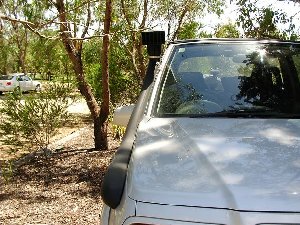

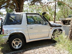

The other day Airflow finally completed the snorkel for Vitara 2.0's. This snorkel will work with the 2.0 V6 and the 2.0 4cyl as well as the 2.0 Diesels in overseas markets. It runs along the guard on the outside and then turns 90 deg and goes straight in to the airbox which I felt was the better option for airflow rather than the alternative which would have taken in to the guard after it had come down the A-pillar which would have meant three 90 deg bends rather than just the one it has. Also it could have been made to hug the a-pillar a bit more closely but again it would have had some effect on the airflow so it is the best compromise given the circumstances. It's taken a while but I am very happy with the end result. :mrgreen:
